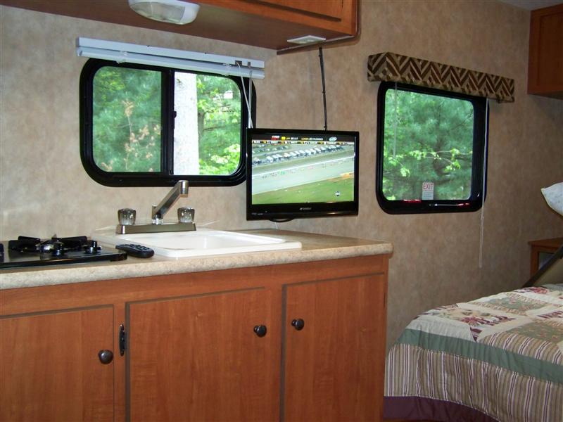

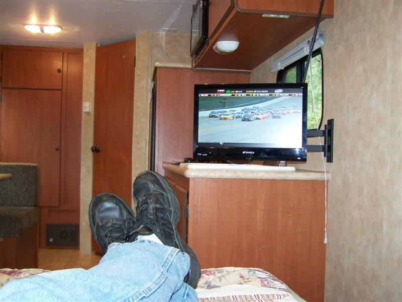

I recently added a 19″ Sansui LED TV to my 190. I used an inexpensive articulating arm mount to accommodate viewing from either the dinette or the bed.
This is the mount I used: http://www.amazon.com/gp/produ…..00_s00_i03
There is a stud just to the right end of the cabinets which I used to screw into. I shortened the mounting screws so that they had 1.25″ of stud penetration.
The view from the dinette:
The view from the bed:
I've found the antenna that comes on the trailer to be quite effective thus far, but only if the booster is turned on. I'm pullling stations from 50+ miles away and the picture is beautiful.

I have a 2012 19SP Spree Escape without one. The answer I got was the valance which is inflamable is too close to the stovetop and so they do not now put one there.
Question on the TV mount. How did you find the stud?
Ahhh, the 'ol "it'll catch fire excuse"! Truth is I didn't even notice until it was brought up. Somehow I will continue to not notice.
On finding the stud, what I should have used was a stud finder. I have one, but was too lazy to go get it. Soooo, see the little tiny hole at the top left of the mount? That was my first attempt, based on the 'ol thumb push test along the wall. Geuss what? Nuthin' but empty space right there! But the wall is super stiff in that area, so I knew it was well framed back there. Next I got a piece of stiff wire, simliar to a paper clip unfolded and did a little probing. I found the stud just to the right of the hole, figured the distance well into the stud and Bob's your uncle.

eocamper said:
I really like this. How/where did you run the wires?
If you look at the pictures you can see the power cord and the signal cable running up to the right side of the cabinet. The 190 has the TV hookups on the ceiling right beside the cabinets, and I just let the cords drop straight down to the TV. Because they run so close to the cabinet they're not offensive looking in the least. There's actually a TV backer built into the wall up there near the hookups, but the way it's set up the TV would be up high and tight to the wall, and I just didn't see it being comfortable to view up there. KZ probably knows this, but as a responsible company they'd probably also have reservations about recommending the TV be so close to the sink.
Heck, at least if the TV starts shooting sparks my valance won't catch on fire.
