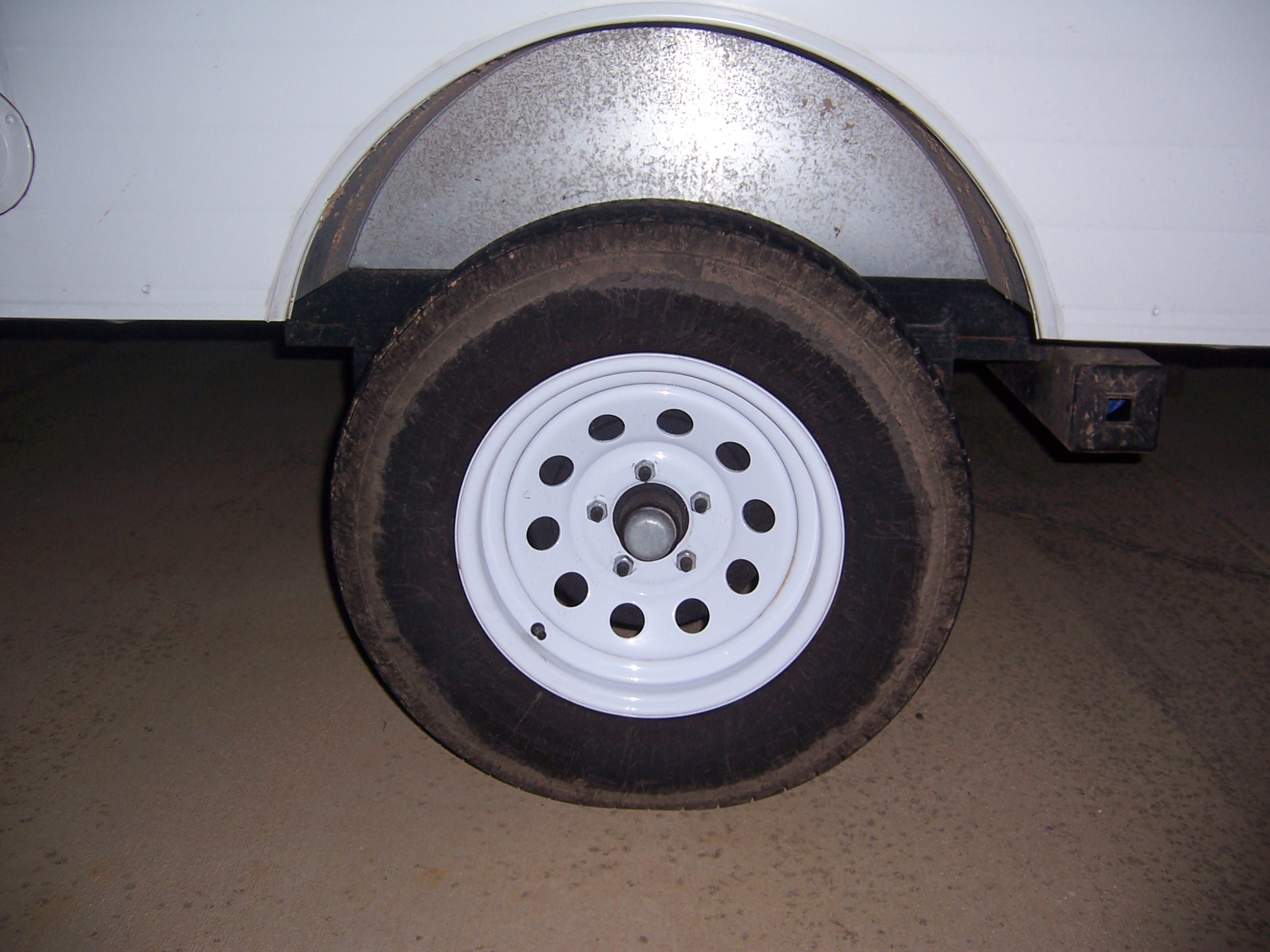

I bought my 2011 Sportsmen Classic 14 FKTH earlier this month and have enjoyed two weekends of camping. This is my first post to the forum. I've experienced some minor scrapes on the jack plate due to ground clearance issues. Other posts on this forum discuss the possibility of flipping the axle to increase ground clearance.
I emailed KZ-RV to inquire whether this would invalidate the warranty.
Here is the response:
"KZ does not encourage or discourage the flipping of axles; it is a common practice to gain clearance with units that have straight axles. I believe that your unit has a drop axle on it, to my knowledge this practice does not apply to this type of axles. When you are pulling this unit are you pulling it level or does there need to be an adjustment made at the "A" frame to assist with this situation."
Upon further examination, I can confirm (see photo) that the axle is not a straight axle. However, does this fact rule out flipping the axle? I have flipped my hitch from a 3.5 drop to a 2.0 rise so I can gain some additional clearance up front.
Thanks,
Bradster

For the sake of clarity, when we refer to flipping an axle, a more accurate term would be to change the setup from spring under axle (SUA) to spring over axle (SOA). SOA in this case would provide additional clearance (the diameter of axle + radius of axle = amount of increased clearance). Literally flipping the axle would probably be a bad idea. My reasoning is that if the axle has a preset alignment geometry, flipping the axle would upset the geometery by inverting the toe and camber of the wheel. This would cause rapid wear on the tires.
A couple of things I've learned:
- The 14 FKTH has an under-slung drop-axle and not a straight axle. (see attached photo)
- KZ stated that the flipping the axle "does not apply to this type of axle".
I don't understand why changing from SUA to SOA would not apply.
Thoughts anyone?

What you are referring to is a spring swap, locating the spring over the axle instead of underneath.
Reference back to my thread about the axle spring swap (back when this board was in it's infancy) and you will see several things.
1) never change the geometry of the axle..this is a bad thing to do.
2) I added new spring seats to the axles, retaining the old ones (mainly due to being too lazy to cut them off and re-use them)
3) The trailer was at the edge of the warranty period and needless to say, I wasn't concerned about anything other than the refrigerator, which was covered by Norcold, so that was a moot point.
4) When raising the Center Of Gravity, you may be in for different handling afterwards. So far it hasn't had any adverse effect for my situation, but may be problemsome depending on layout, wheelbase, driving style.
I did mine because the tires would rub when running off pavement. Prior to the axle relocation, I was scraping the tongue jack time to time, and actually crushed the end one day leaving a gas station on my way home, and unable to unload the trailer until I cut the crushed 1″ off the jack end.
