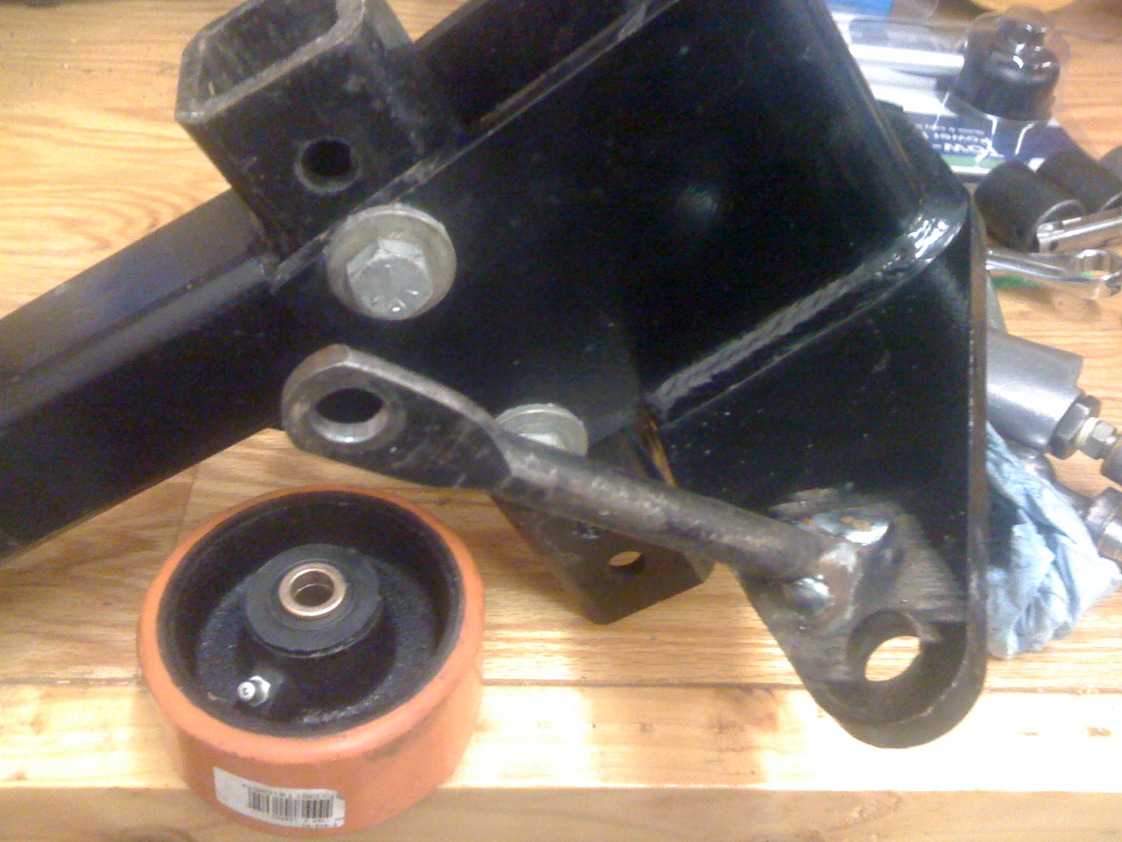

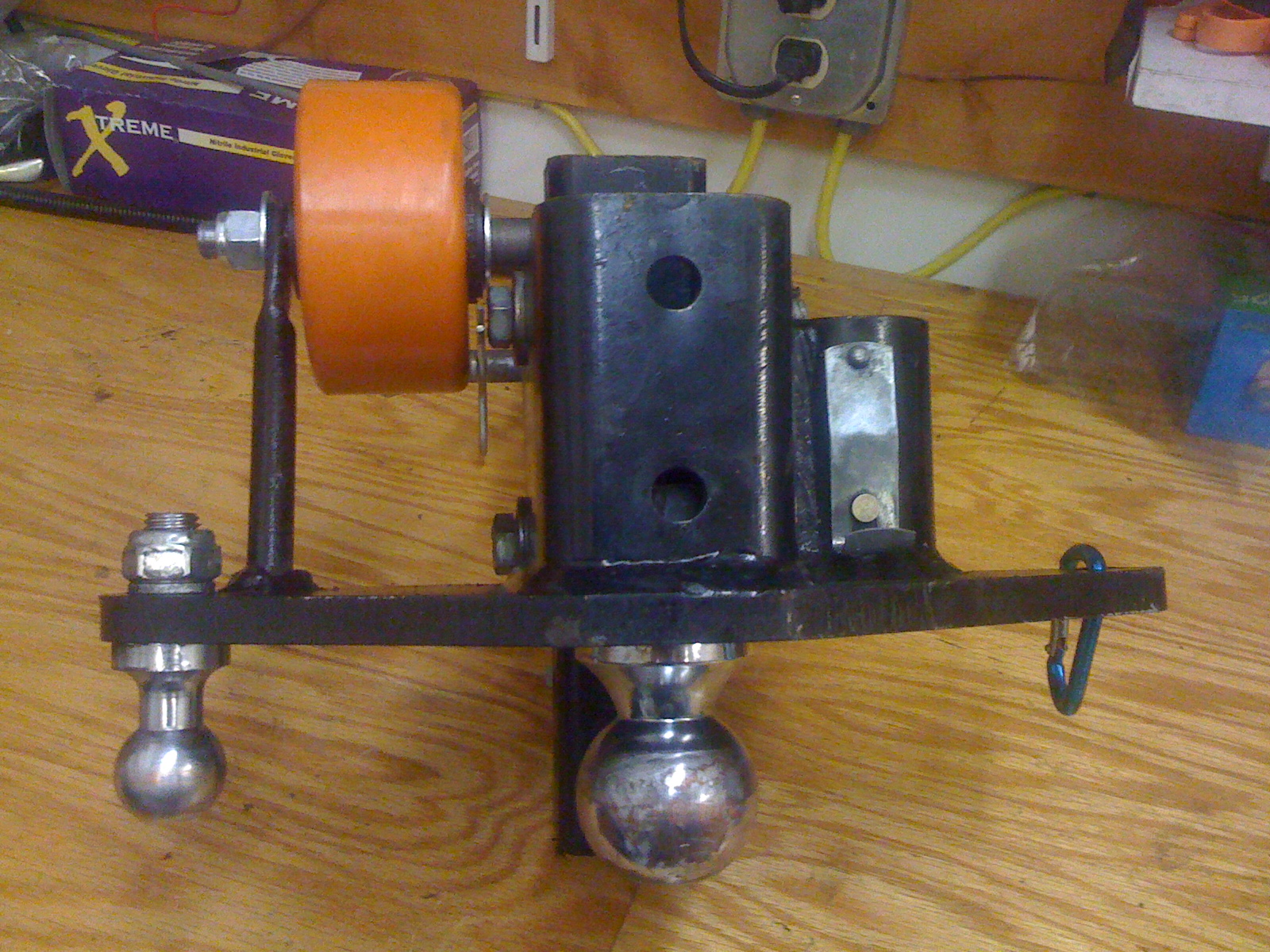

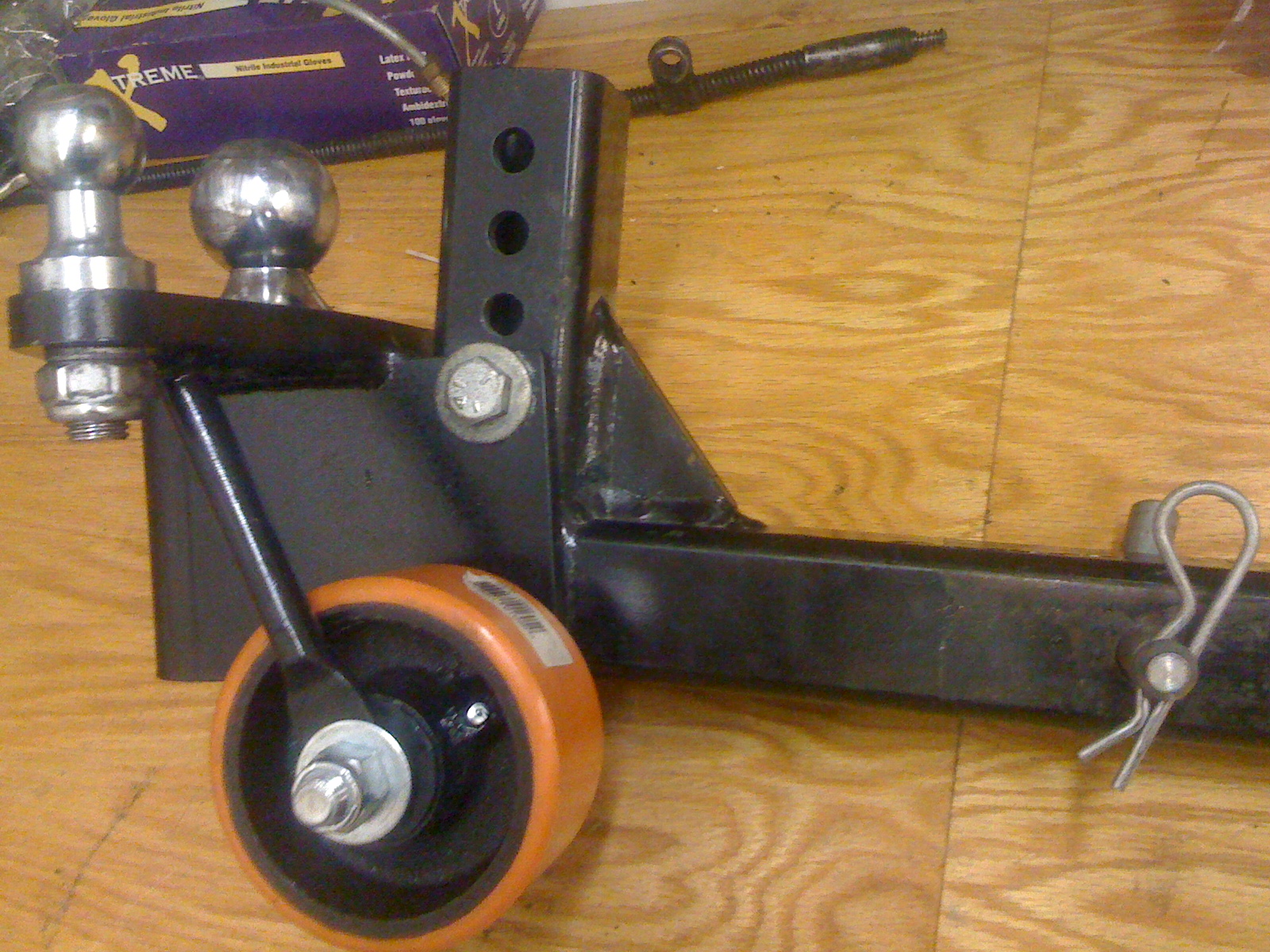

I mounted these wheels to the vee skids on the rear bumper. http://www.adventurerv.net/kwi…..-4872.html I purchased a heavy duty 4″ wheel from Northern Tool to mount to my ball mount.

Thanks for the compliment Stephan. A close look at my welds and a pro may scoff. I turn up the heat and make sure there is plenty of penitration. I learned by just doing it with tips from welders. Inexpensive welders can be had via craigs list. Get one and some scrap metal and with a bit of practice you could do it. Anything that may be a safety issue I have my professional welder buddy weld for me.
