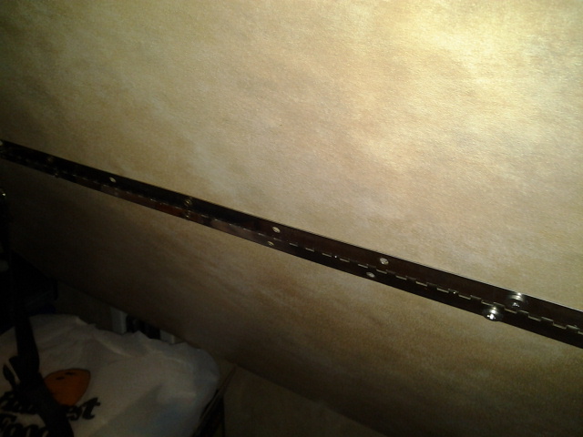

The first is specific to the toy hauler models. The convertible bed/couch sections are joined at the fold by a long "piano hinge". The factory fastened the hinge in place using what look like self-tapping wood screws to me. They put a screw in every other hole on the hinge – some 28 screws in all. After a couple months use, the screws started working their way out and stripping threads.

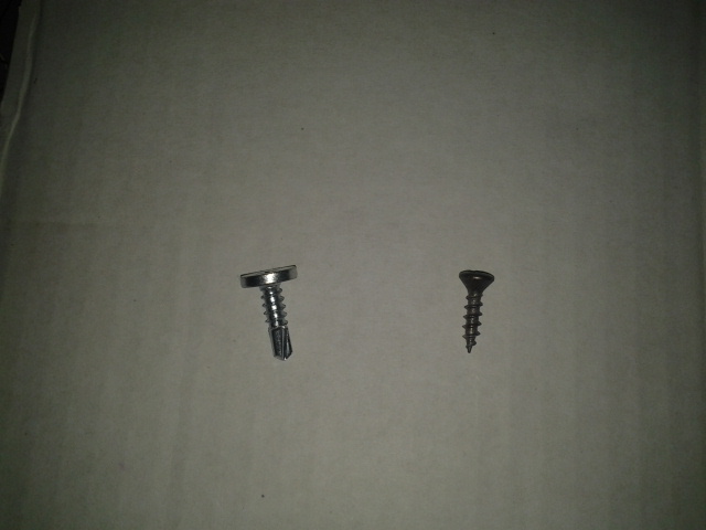

I replaced those screws with #10 x 5/8″ self-tapping screws suitable for sheet metal. The bed frame is aluminum square "tube" about 1.5″X1.5″ x 1/16″ wall thickness. I picked a larger screw with a flat washer shaped head and filled all the holes in the piano hinge.
Below is a picture of the two screw types – old on the right, new on the left.

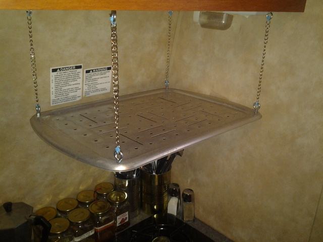

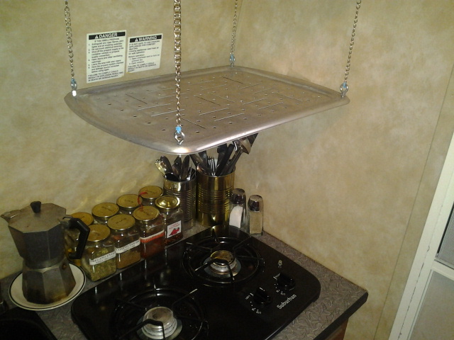

Below are two pics of the extra shelf space we created by hanging what looks like an oven/broiler tray (purchased at goodwill for a buck) over the stove. There is so little shelf space in the kitchen that cooking and washing dishes is a real juggling act. I needed a space to put pots/dishes while cooking/cleaning. I used metal since it was over the stove and hung them with eye-bolts, plastic anchors and chain. It's been very handy. Can't put too much weight on it because of the anchors though.
