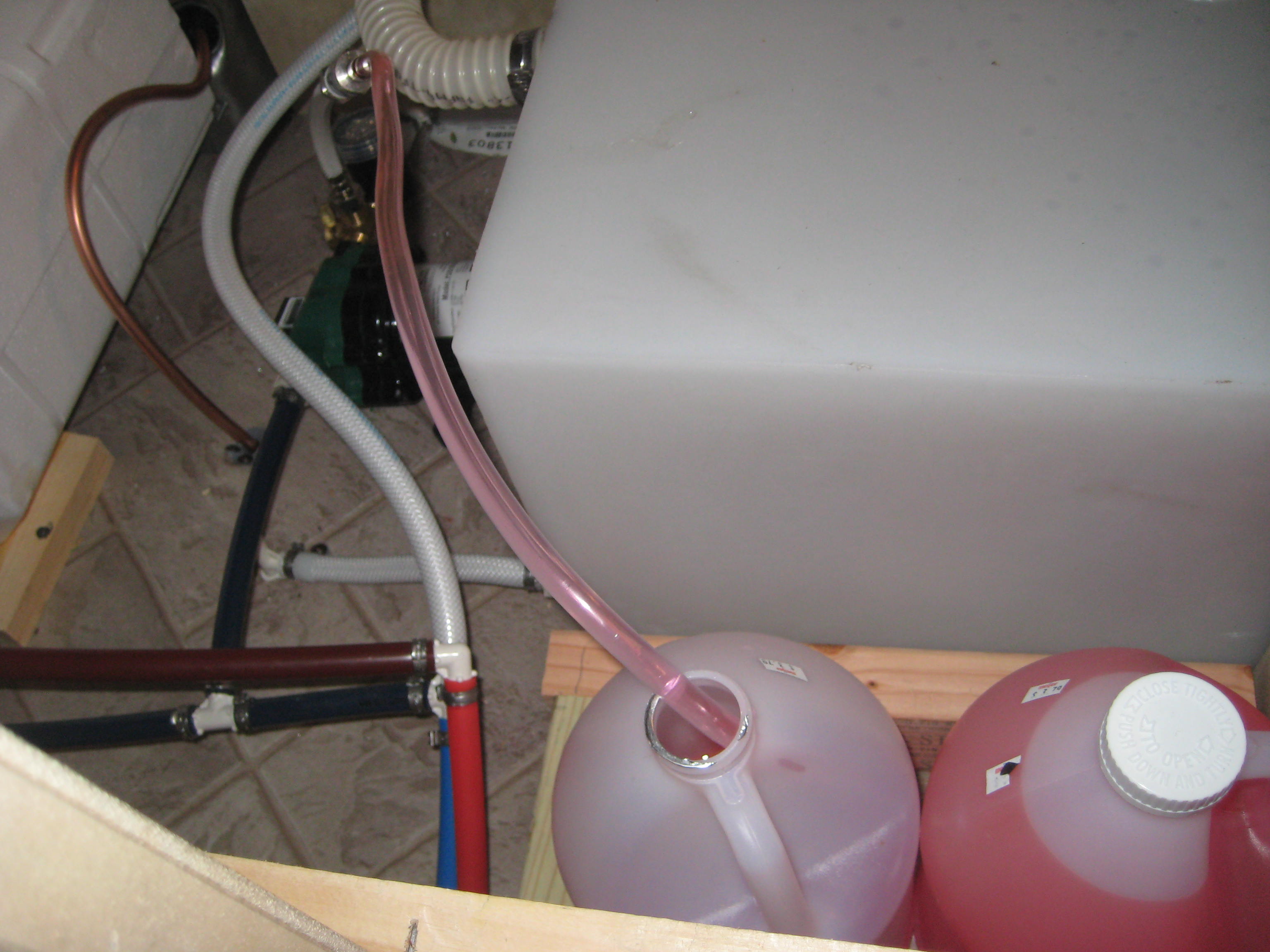

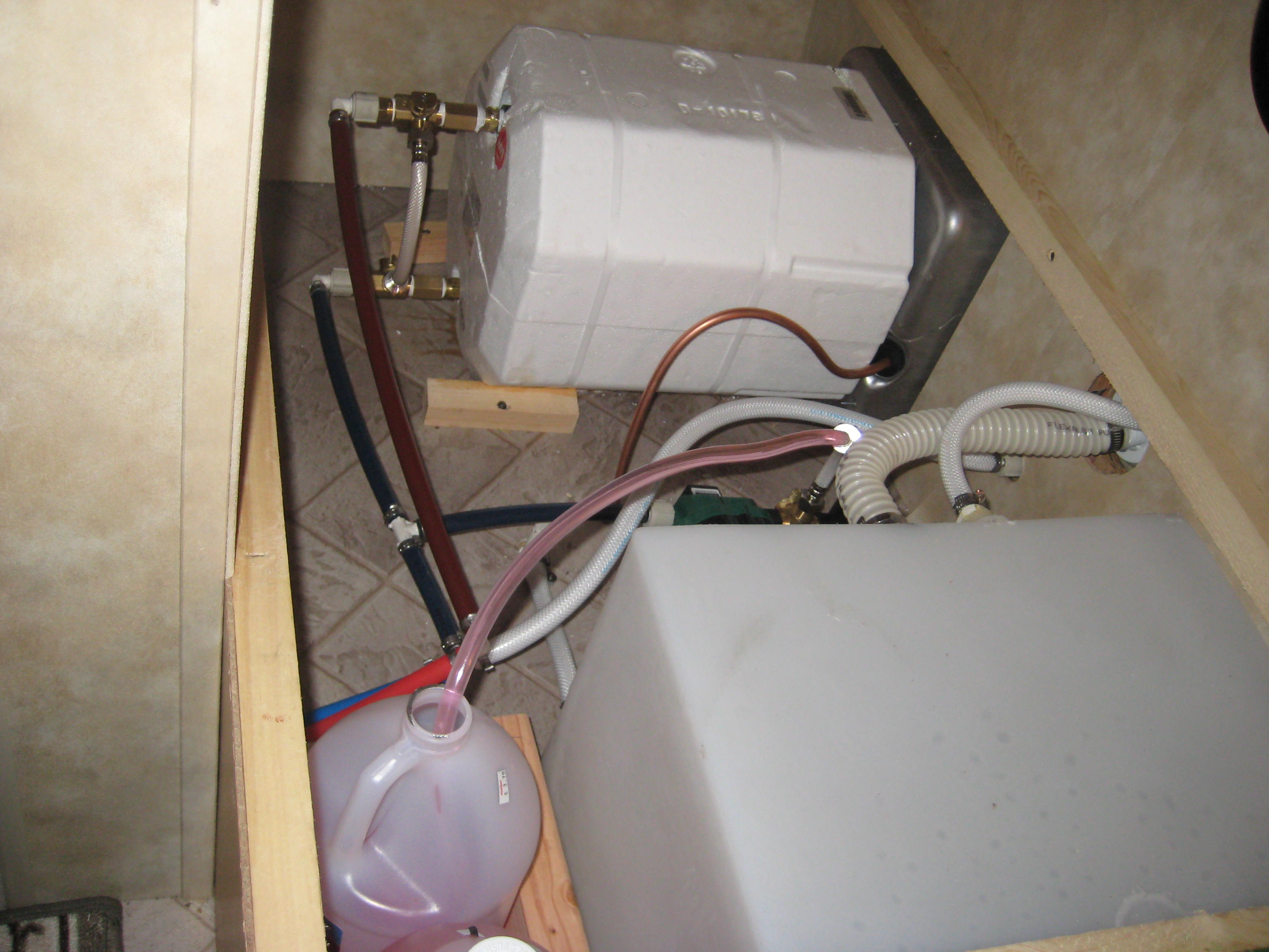

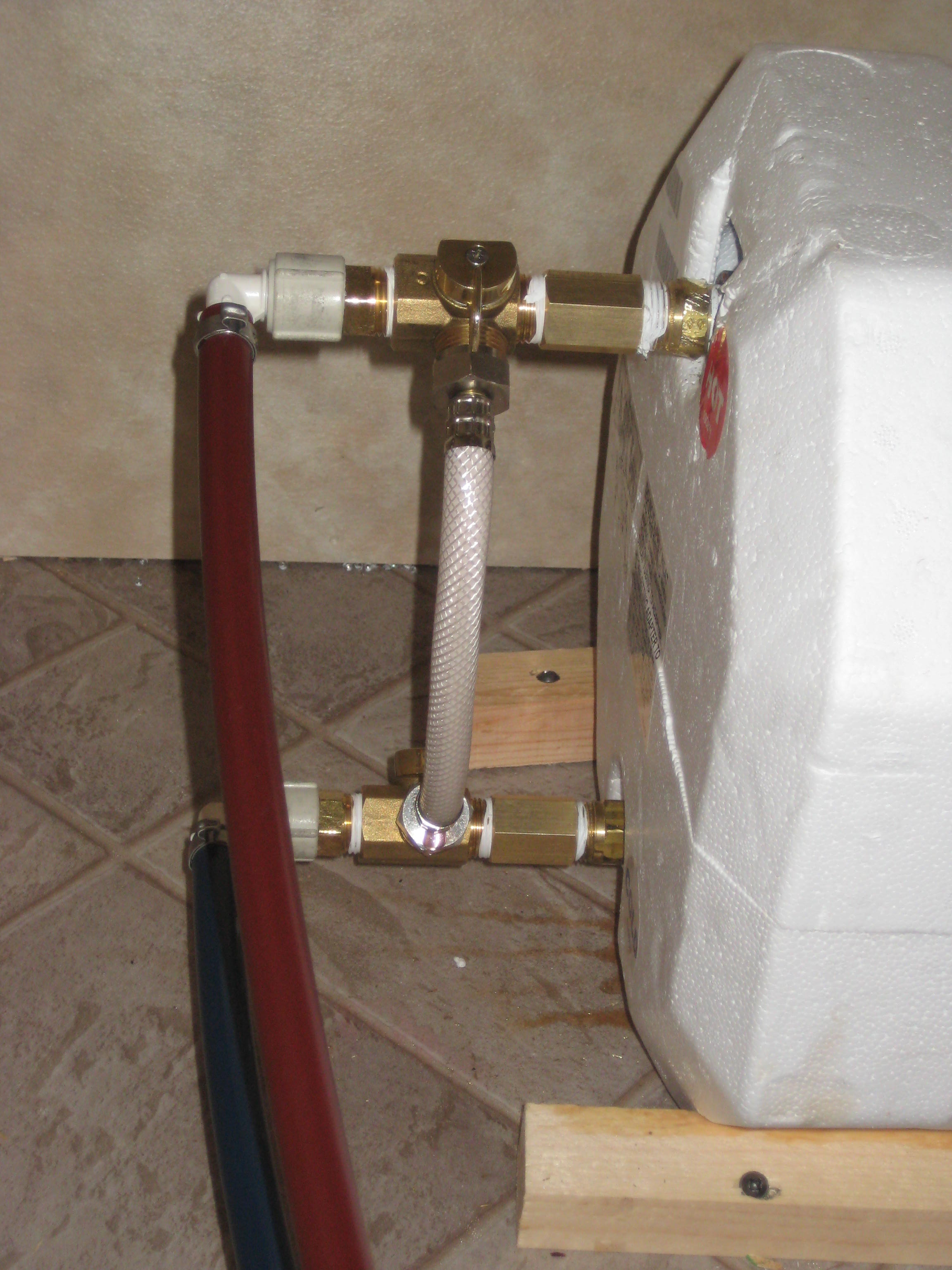

When we were ready for our first trip (It was below freezing) I flushed out the system. Started to add the bypass valves to the hot water tank and couldn’t remove the brass fittings from the hot water tank so rather than damaging the fittings/hot water tank I went to HD and got two female and male brass fittings and hooked up the bypass valves. There was not enough room between the pump and wall to add the bypass valve so I had to move the pump (Simple unscrew, move the pump and re-screw). There were these weird looking clips that someone else mentioned on one of the other posts, I didn’t have to mess with them since there was a screw clamp between the pump and the backflow preventer so that’s where I put the pump bypass. I used the extra hose from the original bypass I did to extend the hose from the pump bypass kit directly to a gallon of antifreeze to an area next to the main tank where I used some scrap 2×4 pieces to make a secured area to store two gallons of antifreeze.
When we returned from our trip from Texas, I drained the main water and hot water tank, flipped the bypass valves and in minutes had the TT winterized and used less than a gallon of antifreeze! Wen we go to Florida I’ll use the drain valves under the TT to empty the antifreeze into a gallon container for reuse, flush the system (Main tank is OK, no antifreeze) and off we go!
