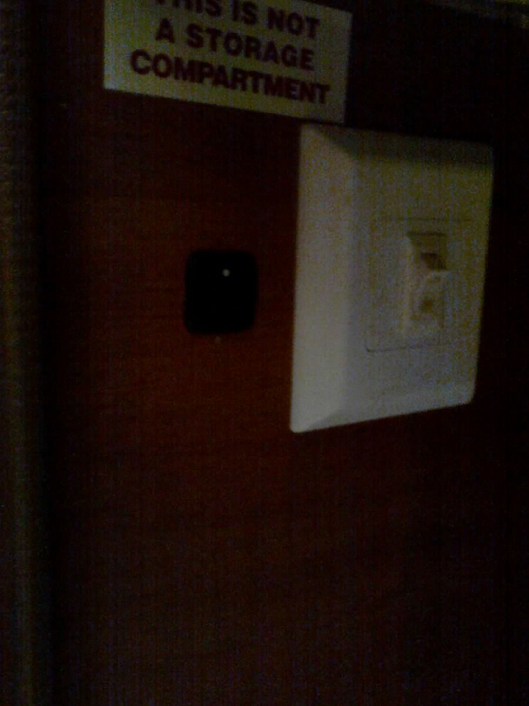

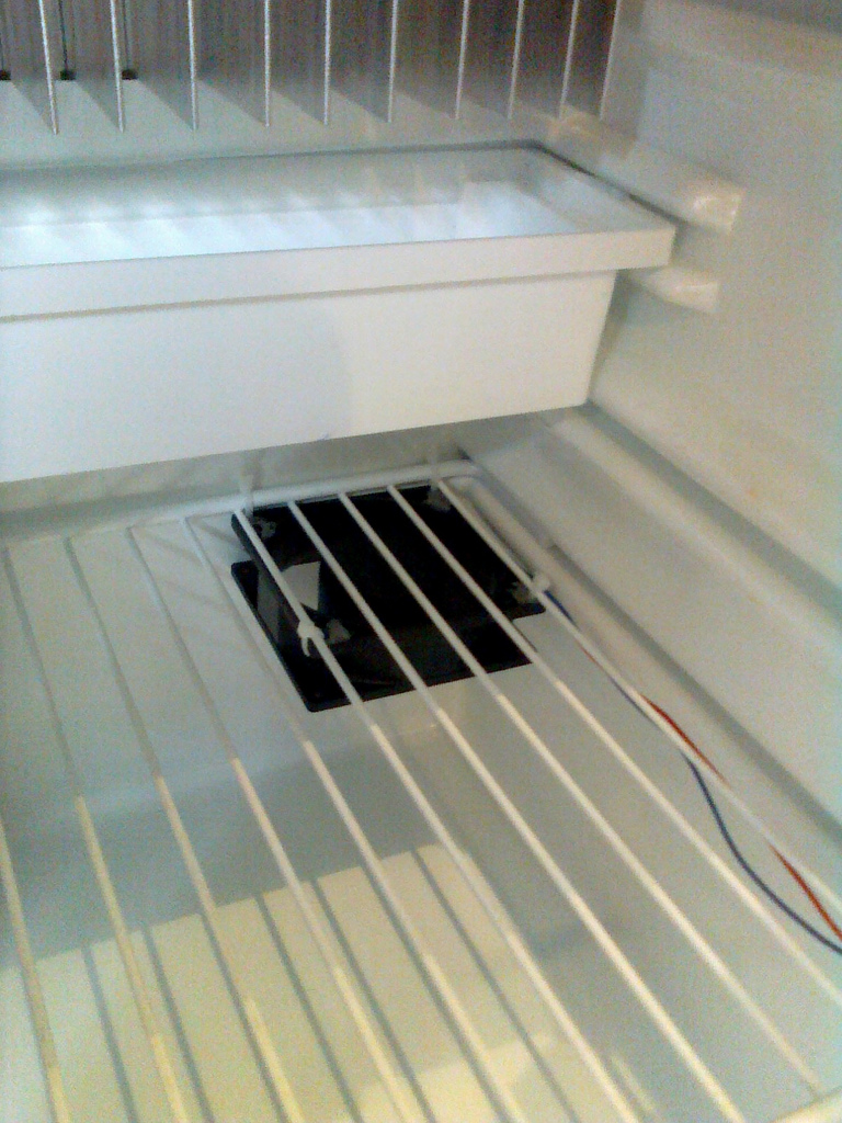

My fridge works pretty good on the outside as far as the refrigeration system goes, but we've had some problems with things freezing near the coils, and other stuff not getting as cool as we'd like.  I'm sure over-packing the fridge doesn't help Smile.  A few days ago on my days off I put a 3″ fan in the inside of the fridge, and put a switch next to the water pump switch (I know there are the small battery powered fans, but I thought I could improve on that).  I'm now considering putting another 3″ fan on the outside of the fridge to help the cooling system, but I'm concerned about the amount of dirt/grit that tends to fly in from the dirt roads we travel and how that would affect the fan operation.  Pics of the inside fan are below.  The pic of the switch is a little dark – sorry about that.
