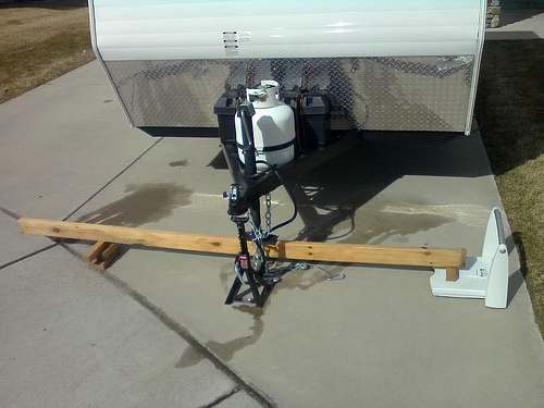

Update:
So today, I got the scale out again today and set up an apparatus to (hopefully) accurately weigh the tongue. It ended up looking like this:
The jack is centered 3' from each point: one side is stationary, the other is the scale. So every scale reading would need to be doubled in order to be accurate.
The results (all tanks are dry, and the trailer has the usual light camping stuff):
Total tongue weight (including 2 grp 24 batteries and full propane tank): 380#
Weight with nothing on the tone (batteries and propane tank completely removed): 300#
Weight with only the batteries and no propane tank: 356#
I honestly was a little shocked. I knew that I'd be close to my vehicle's intended max hitch weight of 350#, but didn't think it'd be that high. And that's without water in the tank. I doubt that anything in the gray/black tanks would affect the tongue weight too much since they're farther back. I plan to go ahead with the plan to install a weight-distributing hitch (Valley #70270). Another potential option is the Reese 350, but I'm concerned there isn't enough room in the middle of the tongue frame for my setup with the two batteries and propane tank.
Happy camping!

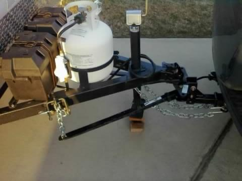

John -
Thanks for the reminder. Here's what I know, and feel free to correct me: The actual aftermarket tow hitch is rated for 500# hitch weight, and 5000# towing capacity, so that's obviously not a problem. The vehicle itself is rated at 350# hitch weight, and 3500# towing capacity. When we tow, there's virtually no weight inside the car in the back (passengers, personal weight-lifting kit , etc).
So, for my situation, with a tongue weight between 350-400#, and a little noticeable sag from the towing vehicle (never any bottoming out situations yet), my intent is to spread out the load to the front of the car. Handling hasn't been an issue at all, but I don't want it to ever be either. I also intend to move as much trailer weight as possible aft, but really – there's not much in that category I can move. The main issue, which is "the way it is", is the propane tank and the two batteries on the tongue.
Last night I did a rough install of the hitch (picture here). One glitch (hitch glitch?) that I was hoping to avoid is that there isn't much room on the tongue frame for the brackets that hold the trunion bars. Most likely I'll have the welding shop install a bracket on each side to accomodate, but that shouldn't be a big deal at all.

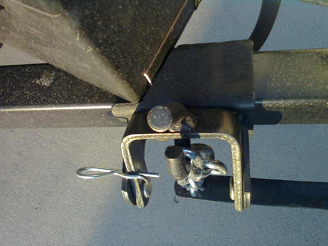

Update:
I took the trailer to the welding shop yesterday to deal with the hanger bracket issue for the weight-distributing hitch. The solution ended up being very simple. He cut off a corner of the bracket go around the existing battery frame, and it works great! The ride was a lot better on the way home, and the RAV didn't look nearly as squatty in the rear end. The cost ended up being around $90, which I thought was reasonable. I haven't had any sway/wandering issues, so I don't think sway control is necessary to add, but I haven't completely ruled it out yet. It wouldn't be hard to add later.
Other pics available here.
